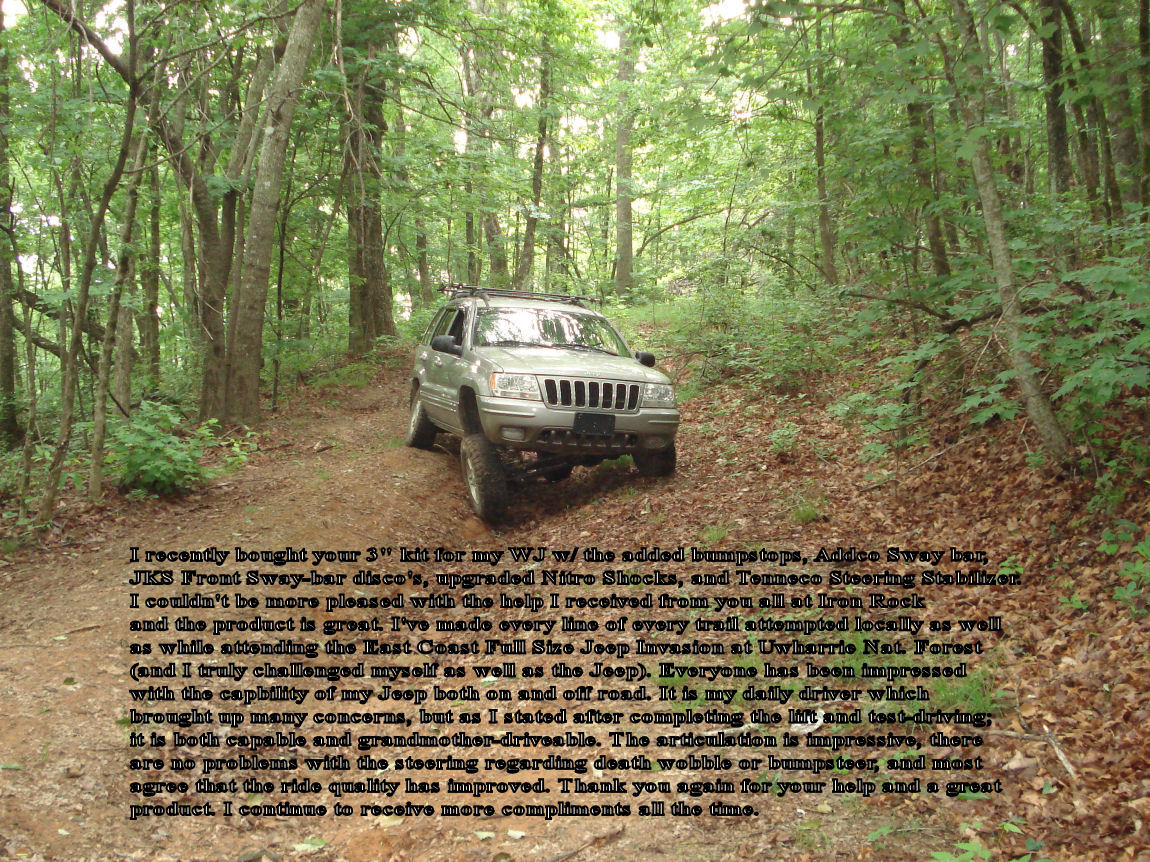

Hi,
I have a 99 Grand Cherokee and would like to lift it with your 3" kit, including the Doetsch Tech 8000 shocks with integrated bump stops, plus the sway bar disconnects. Basically, I would like it to flex well and have extra height, but without causing any detrimental effects on driveline etc.
Just confirming that I would need nothing else other than what you advise in http://www.ironrockoffroad.com/Merch..._Code=IR-W_3LK
to do this.
Is there anything else that is in addition to the above kit that this guy has? Steering stabilizer? Addco swaybar??
http://www.ironrockoffroad.com/Merchant2/Karlb12.jpg
Would I need what he has?
Also, what would be the shipping charge for all this to Queensland in Australia? You can use the address below as a guide as it is only 15kms from where it would need to go to.
I've heard good things about your kits http://www.ausjeepoffroad.com/forum/...ad.php?t=69097 so hopefully will work for me.
